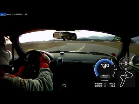

    3. The OBDII data on my setup were recorded correctly during the problematic run, and were usable ( see the second part of the onboard video )
    Any help will be appreciated! :)
  • Hello papdoc. On the video it is clear that just ODBII data were available. Did RC record any gps data during the race? It is not clear if the data collected when the system was not working were inconsistent (for instance when the route is not well drawn) or if RC did not recorded any gps data during the run.
  • Hello vinpippo and Happy New Year!
    Yes GPS data were recorded, but they were inconsistent so I didn't used them on the video. With Trackvision I can choose which data to use, so I left the crappy GPS data out.
